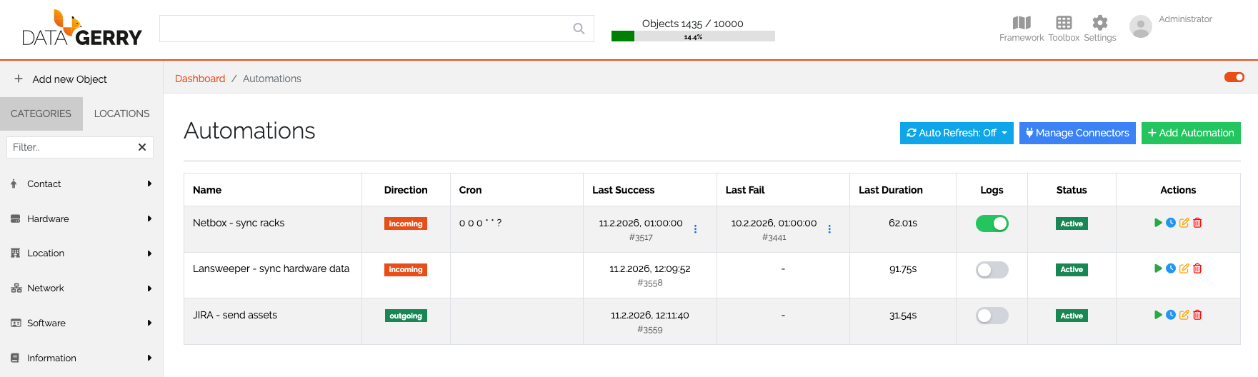

Automation Overview
../_images/automation_overview.png
Picture: Automation overview
Accessing Automations
To access Automations, navigate to the Toolbox menu in the DataGerry dashboard, and select the Automations sub-menu. You will be presented with a table displaying all created automations, which includes the following key information:
  • Name: The name of the automation.
  • Direction (Data Flow Direction): Defines the direction of the interface—either Incoming, Outgoing, or Internal.
  • Cron Expression: The time-based configuration that defines how frequently the automation will run.
  • Last Success: The last successful execution time of the automation.
  • Last Failure: The last time the automation failed.
  • Last Duration: The duration of the last automation run.
  • Logs: Logs that can be toggled on or off for monitoring the automation’s activity.
  • Status: The current status of the automation (active, inactive, etc.).
  • Action List: Here, you can start, edit, adjust the cron expression, or delete the automation.
Automation Refresh
You can enable auto-refresh for the Automations page, which ensures that you are always seeing the most up-to-date status and data related to your automations.

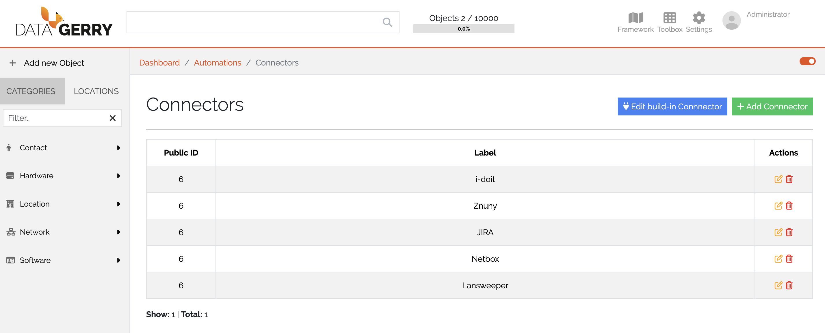

Managing Connectors
In the Automations section, you can manage and configure connectors. You can modify existing connections or create new ones to send or receive data from various sources.

Manage Connectors
The Manage Connectors section allows you to configure and maintain connectors that are used within Automations. Connectors define how DataGerry communicates with internal or external systems.
Built-in Connector
The Built-in Connector represents the DataGerry system itself. It is used when Automations interact directly with the local DataGerry instance.
To configure the Built-in Connector, the following information must be provided:
  • URL of the DataGerry instance
  • Username
  • Password
In the DataGerry Cloud version, an additional field is required:
  • x-api-key
The x-api-key can be obtained from the DataGerry Service Portal.
Add Connectors
You can also create connectors for third-party applications.
To create a new connector, click on Add Connector.
This opens the Add Connector form, which is divided into two sections.
Left Side – Meta Information
On the left side, general connector settings are defined:
  • Name of the connector
  • Description (optional)
  • Invoker
  • SSL Verification (enable/disable)
  • Timeout
The Invoker represents the API definition of the third-party application. It is a core component of a connector and ensures that:
  • The authentication mechanism of the third-party API is understood
  • The available API methods can be accessed within the Automation IDE
Right Side – Authentication Configuration
On the right side, the required authentication fields are displayed dynamically, depending on the selected Invoker.
Typical authentication fields include:
  • API URL
  • Username / Password
  • API Token
The exact fields depend on the authentication mechanism required by the third-party system.
Testing the Connector
Before a connector can be created and saved, a Test Call must be performed.
To validate the configuration:
  1. Fill in all required fields.
  2. Click the Test button.
  3. Ensure the connection test is successful.
Only after a successful test can the connector be saved and used in Automations.
